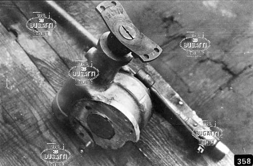

Hi Sandy,
You are tust the man.
The trust have a great photo as well im interested in the cars, my belief is that they may all have been T13 with twin magnetos but im looking for more examples. sadly there seem few period photos.
Whats your view on 1612 -1650? were they all race cars?

 Post subject: Re: Brescia modifiee
PostPosted: Fri Jun 15, 2012 2:34 pm
Posts: 127
The example I cited, chassis 1645 is a T23 which originally had a touring body and is single ignition, so it is unlikely they were all race cars. There do not seem to be many survivors of the immediate post-1612 Brescia's and even fewer with their original engines (and steering boxes) still fitted.
My engine no. 5 was twin magneto and found around 1950 near Schenectady, New York fitted to a sprint car owned by "Pappy" Grizbach. The twin magnetos and aluminum cradle were intact and fitted, but I have never found a photo of this car and installation.
Sandy
