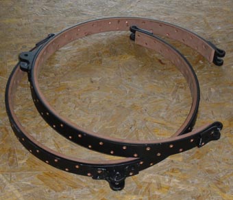

Brakes are ready .

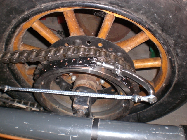

The steel cable will be changed?
 Post subject: Re: Type 5 news
PostPosted: Fri Sep 09, 2011 9:28 pm
good question . I have no drawing for the cable , only fotos . This one has 6mm , I can go to 5mm .
PostPosted: Sat Sep 10, 2011 7:33 am
I guess 5 or 6mm would not make a big difference, but are the cable ends periodic?
PostPosted: Sun Sep 11, 2011 2:17 pm
It looks to me 6mm is to big . I do not anderstand the question " periodic" ?

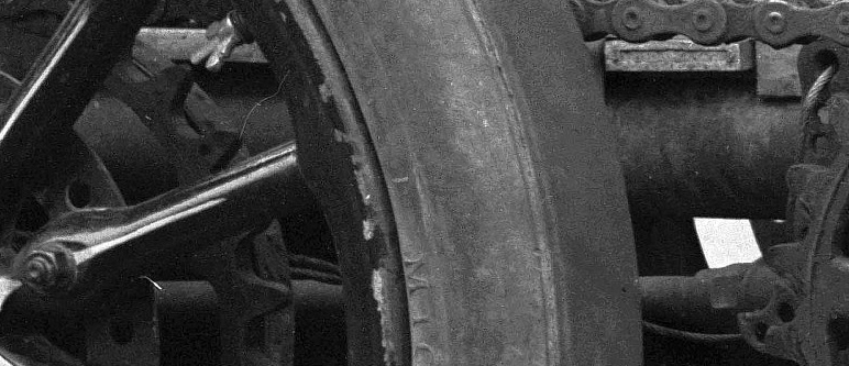

It is one cable , it goes from one wheel through a pipe to the other side to the second wheel . So the cable can move to make a compensation . And you can see the cable is double up to behind the tire . All the older Bugatti cars had this system .The Type 4 has a pipe with 26x4 mm , so the hole has 18mm , If this hole is 18mm , how big is the cable ?
No "periodic" is an interesting new word for what I think should be "in period" or "as original."
PostPosted: Sun Sep 11, 2011 3:24 pm
OK, to be more clear: The fittings on the cable look crap. Did the original have these kind of fittings?
PostPosted: Sun Sep 11, 2011 3:38 pm
this is a standard fitting today . Type 4 did use it . I better do not show the fitting Bugatti did use for the Type 5 . It looks like , Bugatti did build the Type 5 over night with everything he can get from his shelf .
PostPosted: Sun Sep 11, 2011 5:53 pm
Why not copy the system used for the baby bugatti? The cable is run through a tube,then returns through the same tube,the tube is crushed and the cable soldered within.
PostPosted: Sun Sep 11, 2011 6:30 pm
I try to be as original as possible
