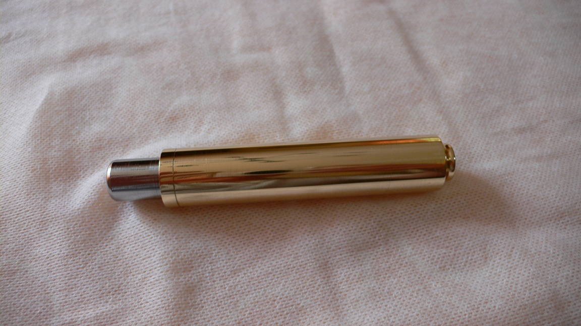

PostPosted: Sun Sep 18, 2011 1:26 pm
Hi,
And here the finished part.
Greetings:
minime
