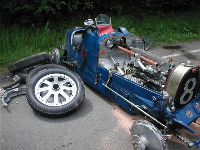

PostPosted: Thu Jun 02, 2011 2:25 pm
 Post subject: Re: Accident
PostPosted: Thu Jun 02, 2011 2:32 pm
Do you have more info?
Quite some work to do on that car...
PostPosted: Thu Jun 02, 2011 3:21 pm
Is this the replica that was crashed, after which the chassis was sold as an original?
PostPosted: Thu Jun 02, 2011 3:30 pm
the front spring hanger is broken off , the " Original chassis " did not have this damage .
PostPosted: Thu Jun 02, 2011 4:05 pm
Posts: 46
Correct Jaap
This is the 100 % original 21st century Pur Sang from Argentina driving with the number '4595' (Pur Sang gave it the identity BO 302). On this picture each and every part is from Anadon
After the accident the owner was hoping to qualify for the 'three out of five' rule by replacing some original Molsheim parts including a frame.
For me it remains a Pur Sang with some Molsheim parts
Kees

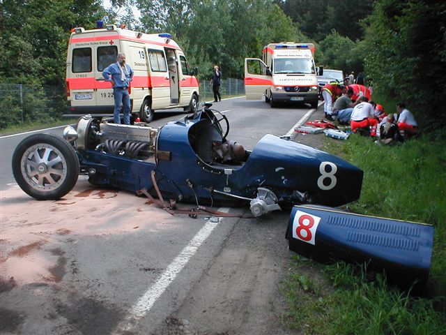

PostPosted: Thu Jun 02, 2011 7:53 pm
We're all very much preoccupied with originallity here, but: did the driver (and passenger?) survive?
And: What was the cause of the accident? Some of us would be happy if it would have been caused by failure of some PS parts...
PostPosted: Thu Jun 02, 2011 11:06 pm
driver did survive
PostPosted: Fri Jun 03, 2011 8:53 am
Posts: 46
He was thrown out of the car and escaped remarkably- to everybody's surprise- without harm.
Otherwise the tone in my reply would have been different
As far as I know it was not a mechanical problem but he just drove too fast.

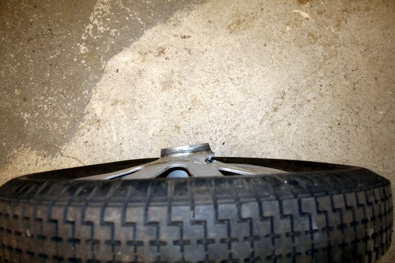

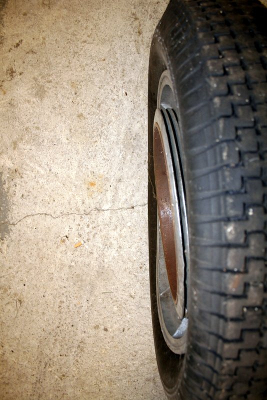

Time to check the wheels for pre-accidental cracks...
PostPosted: Fri Jun 03, 2011 8:25 pm
I would be looking very closely at these wheels.I have a damaged Bugatti wheel here which is very badly damaged after hitting a wall flat out.[ the driver died,the front axle was bent round almost 90 degrees until the wheel hit the side of the bonnet,but the chassis dumbirons did not break ] BUT it is still intact,very bent but not shattered like the wheels in the photograph.....It must be remembered however that this is a T51 wheel which was made stronger by the Bugatti factory so maybe the earlier wheels were a serious problem.

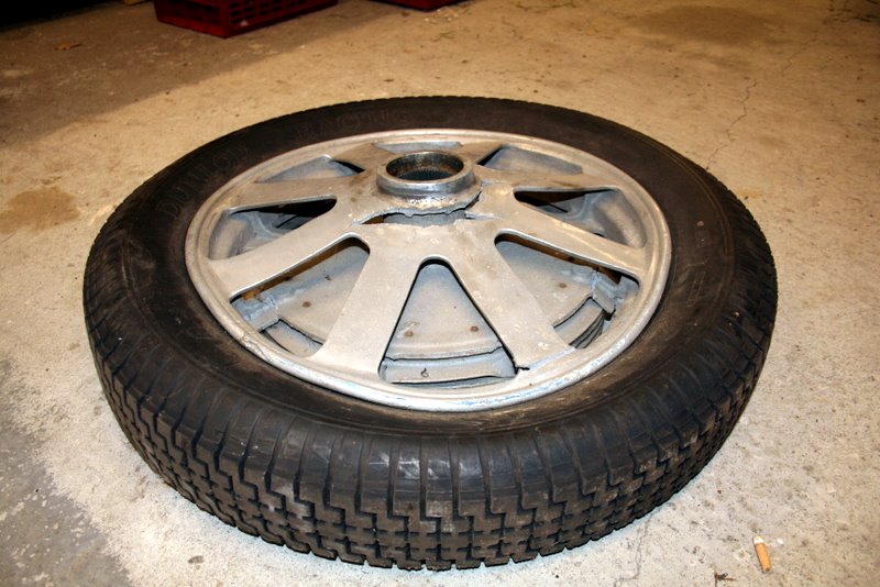

PostPosted: Fri Jun 03, 2011 8:26 pm
If I were the owner of an argentinian car,I would be taking my wheels off now for crack testing......here is another photo.
