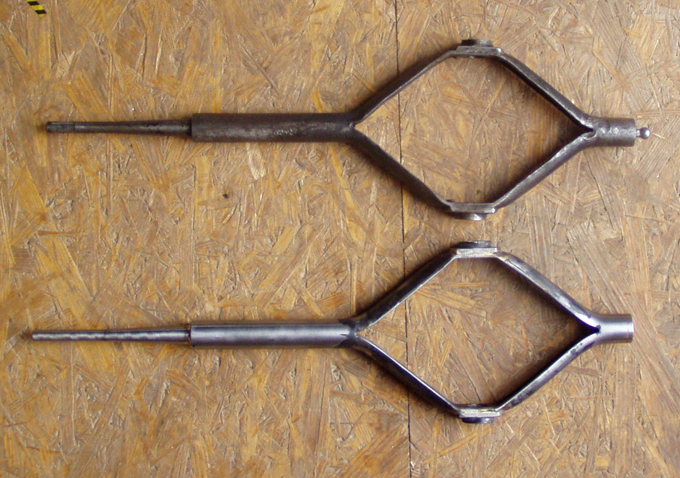

What is the name in English for this part . It is not so easy to make if you like to have it perfect straight and exact like in the drawing . I had to make some special tools for it . The part at the right is an original .

A yoke? (not a joke)
 Post subject: Re: Bugatti part .
PostPosted: Sun May 29, 2011 5:30 pm
like a clutch bearing yoke ?
PostPosted: Sun May 29, 2011 6:13 pm
Possibly, "yoke" is very general. It can be about anything with a forked shape.
PostPosted: Sun May 29, 2011 6:18 pm
yoke in german is Joch . A Joch can be anything . Or a Joch is something , what keeps somthing in place .
PostPosted: Wed Jun 08, 2011 11:54 pm

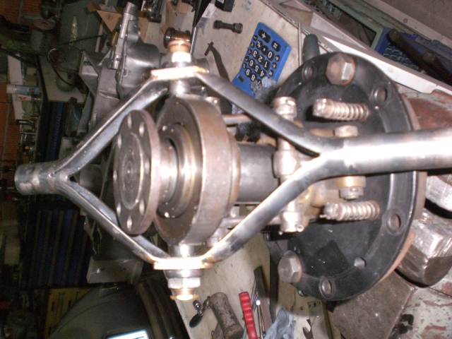

I think it looks very original .

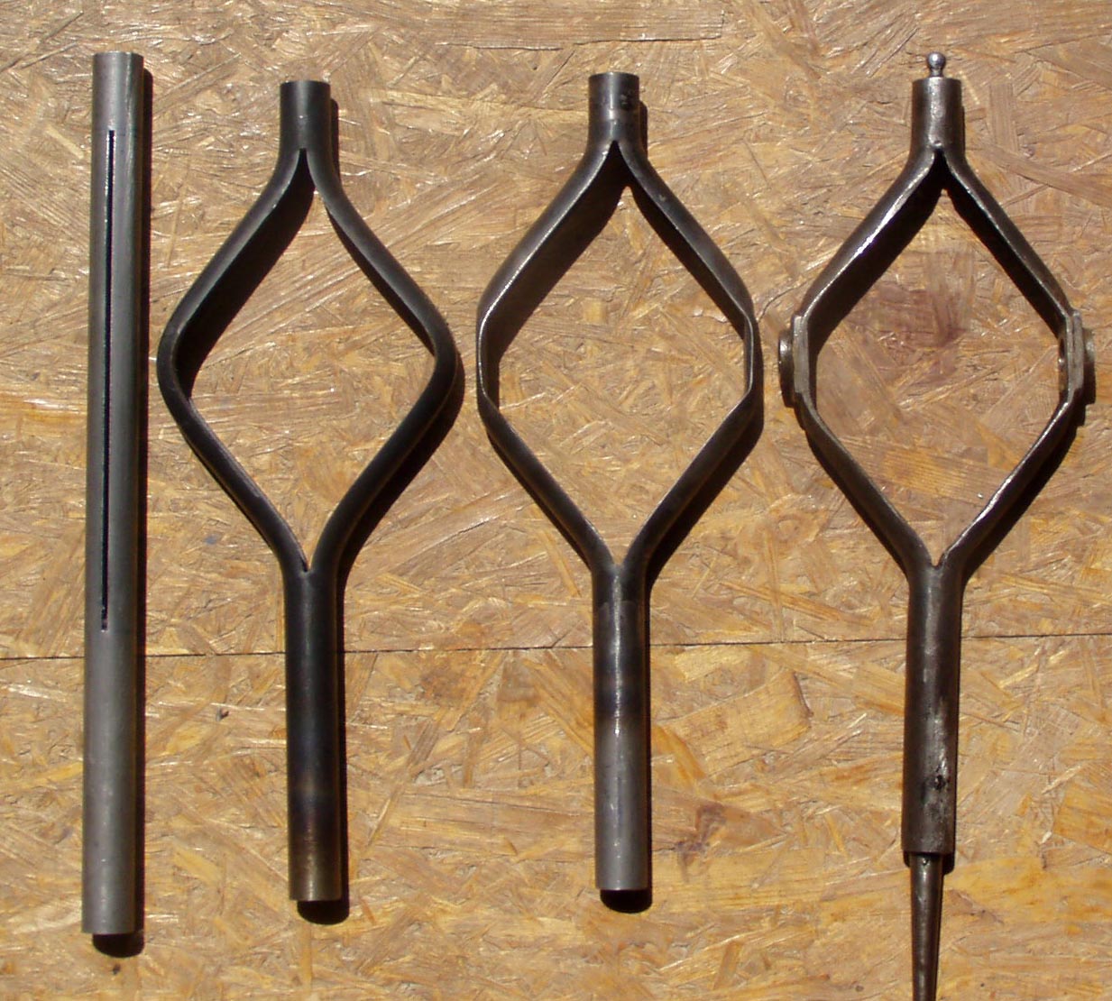

first one is ready . The top one is original . Tube 22mm x inside 14mm

Udo - looks good. What did you use to cut the slit in the tubing? Just curious.
Dan
PostPosted: Fri Jun 17, 2011 3:18 am
in a milling machine . disk diameter 80mm , 2,5mm wide , 50 tooth.
