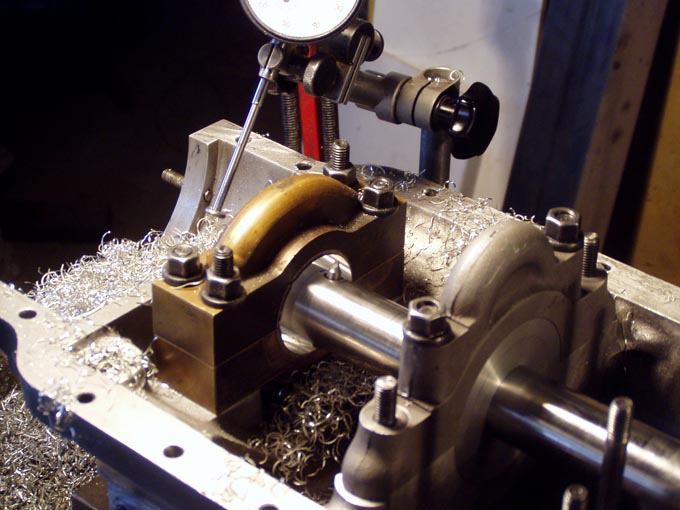

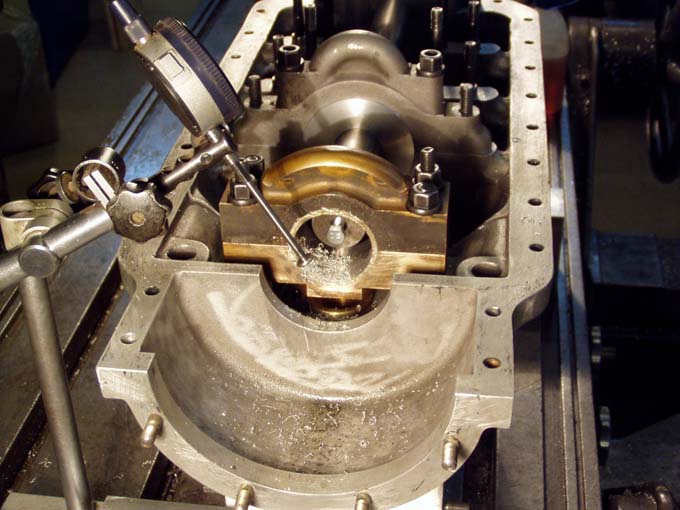

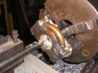

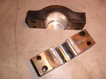

It is not so easy to use centrifugal force to get the babbit in to the first bearing . Babbit bearings made with centrifugal force are much better compare to pure the babbit static .I use the same device for centrifuge and rough machining .
 Post subject: Re: Bearings for T37
PostPosted: Thu Mar 03, 2011 3:32 pm
Do you poor the babit in while the fixture is spinning?
PostPosted: Fri Mar 04, 2011 1:26 am

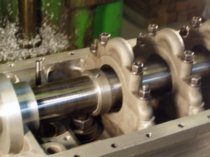

first spinning with maybe 50 rpm and heating it up , after the babbit is in and the temparature is OK go to 1000rpm .But there are some secrets . Line boring the front bearing . About 1mm has to go .

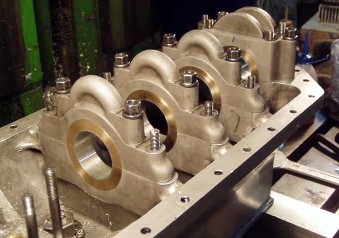

front bearing is ready

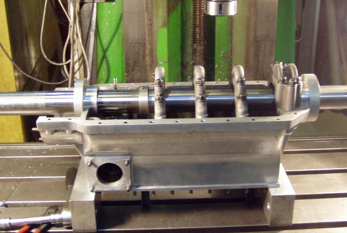

OK, I will think about it , but Udobugatti sounds good . I like it , "The Bugatti club had some 8mm nuts made by a mistake " . The alluminium crankcase is a new one from England , but I had to make a line bore for the main bearings . Bearings diameter 69mm
0,15mm out of round . Can anybody tell me how to make a egg shaped line bore ?

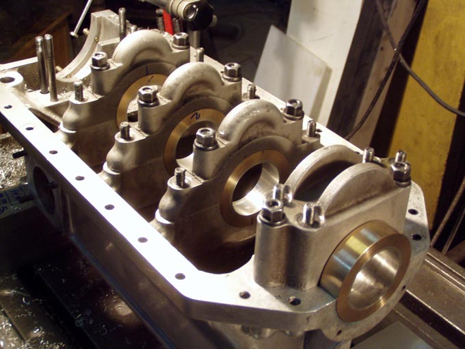

almost ready .
