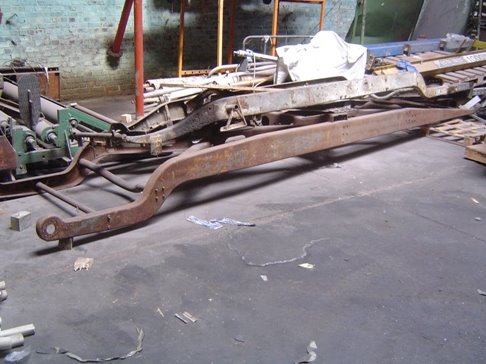

Hold on... I understood the Royale chasiss in the reserve collection was made post-1960, ordered by Schlumpf. How come they would have chosen a T61 chassis, instead of T41??
Are there pictures of the Schlumpf Reserve Royale Chassis?
 Post subject: Re: How many Royales? (2)
PostPosted: Fri Feb 25, 2011 12:54 pm
Here is the chassis ex Arlette Schlumpf.The size can be imagined from the chassis sitting on top.A T46 !!
