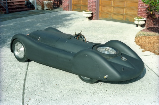

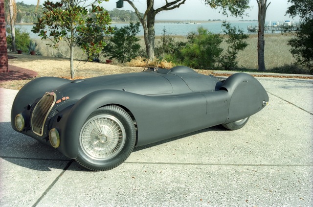

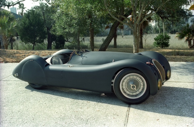

Here are some photos of a recreation of the 1937 ACF car Type 59/50B. I purchased the project from Ray Jones who had been working on it for nearly 10 years. It will be completed over the next two.
Quite beautiful and it should be a treat to see in person, as I believe that no one likely still alive has seen the car since 1937-8

 Post subject: Re: Bugatti Type 59/50 B
PostPosted: Tue Apr 13, 2010 6:51 pm
magic pure magic.
PostPosted: Wed Apr 14, 2010 8:26 am
Once again, superb recreation of Ray Jones, is the fine work. Thanks for these photos.

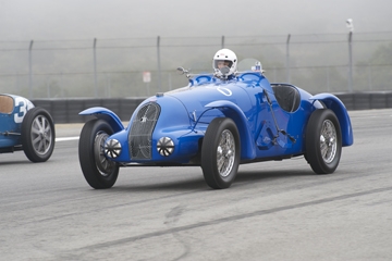

Here is 57478 with replica T59/50B body:
