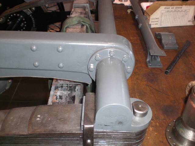

How is the center tube conected with the autside spring hänger ?

A bolt goes through the spring hanger and the tube. Remove the spring and you will see it. Thought you would know that.

can you show any foto how it looks ? Has the bolt a counter sunk head , so the spring hanger is flat underneath ? What diameter can it be , like 8mm ? Has the inside tube a thread or is a nut inside ?

Both spring hanger and tube has a thread.

counter sunk ? 8 or 10 mm ? Foto shows T28

14mmX 1.25P

OK , 14mm . What about the counter sunk head ? Or is a hole in the spring for the bolt head ?

T44 , T50, T41 has a rivet with a counter sunk head .
