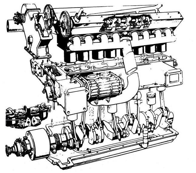

I understand the single overhead camshaft drive through bevel gears...but how is the twin cam engine driven ? I can't find pictures of how..is it through bevel gears...or chains or etc...

I believe there is a cluster of gears that tie the 2 cams together.

On the type 50 the crankshaft drives a vertical shaft, which ends on a large gear. That gear drives the camshaft, but with a smaller gear in between, to cover the distance.
i will see if I can put up a photo.

Type 59

Thank you for the explanation and drawing.
I couldn't visualise how a vertical shaft with bevel gears as in the t35 could transmit to two camshafts..
now I see its all done with cogs.

Totally wrong!
Drawing shows a T59 engine!
T51 uses the T35 vertical drive and in top the drive is by gears to the cams.

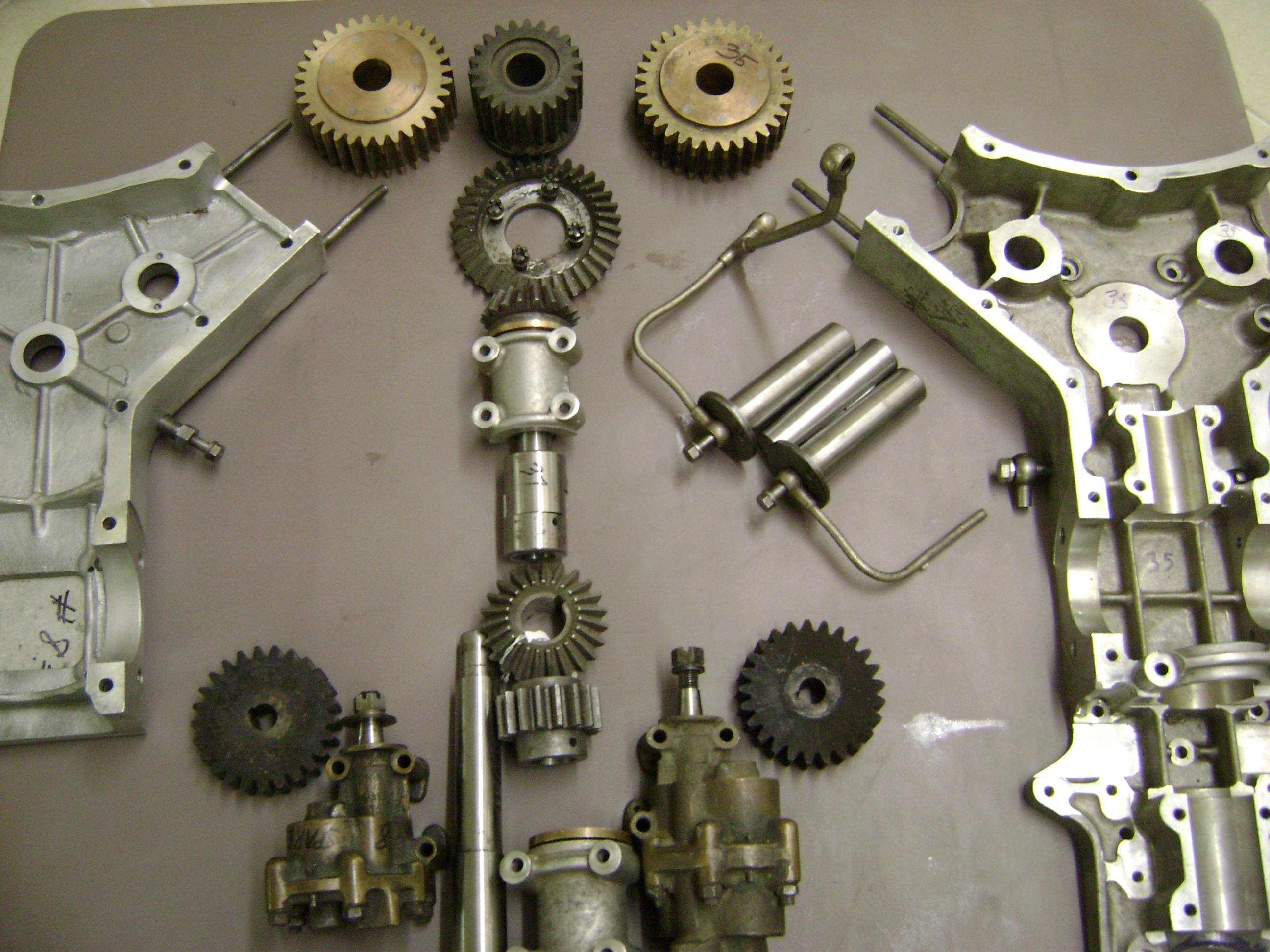

The twin camshaft are driven by a series of gears on the back of the engine for 57's and 59's, engines designed first hand as twin camshaft. The arrangement for type 50 and 51 is of a different nature as the base of those engines were initialy single camshatfs, eg repsectively type 46 and type 35. The driven in this case is at the front of the engine, bevel gear from crank shaft then again bevel gear in seperate casing, than series of three straight gears to get to the camshaft. A good book well illustrated and explaining this is "Bugatti Doubles Arbres" by Robert Jarraud.

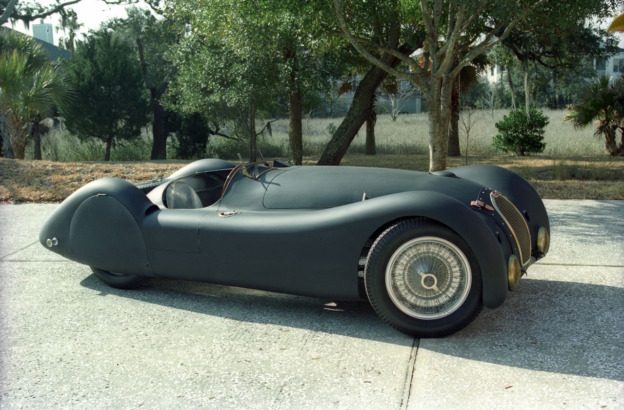

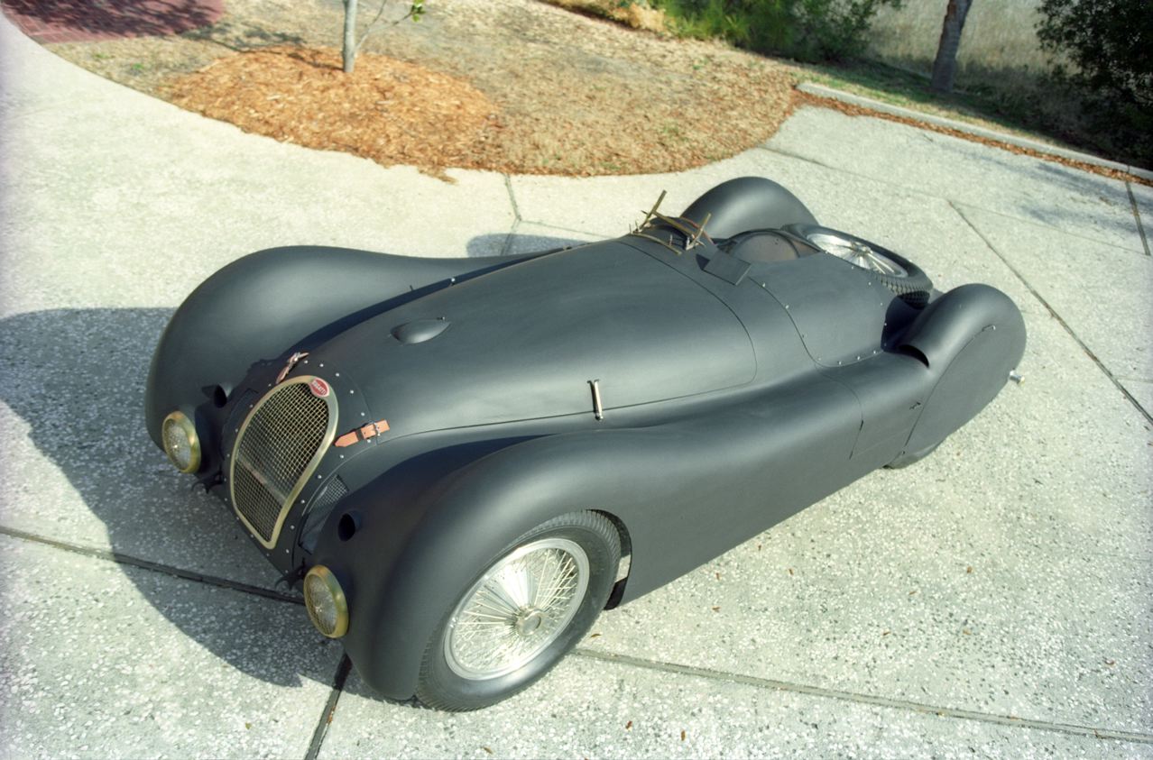

Enclosed is a photo of the Type 50 tower drive. It is part of the Ray Jones recreation of the 1937 ACF Type 57S45. Effectively a Type 59 chassis with 57S45 gearbox and Type 50B engine. I enclose photos of the car as it is currently. I purchased it last year and hope to have it completed in 2011. Should be quite a site on the road, as there is likely no one currently alive that saw the original car run in period.
