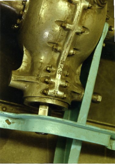

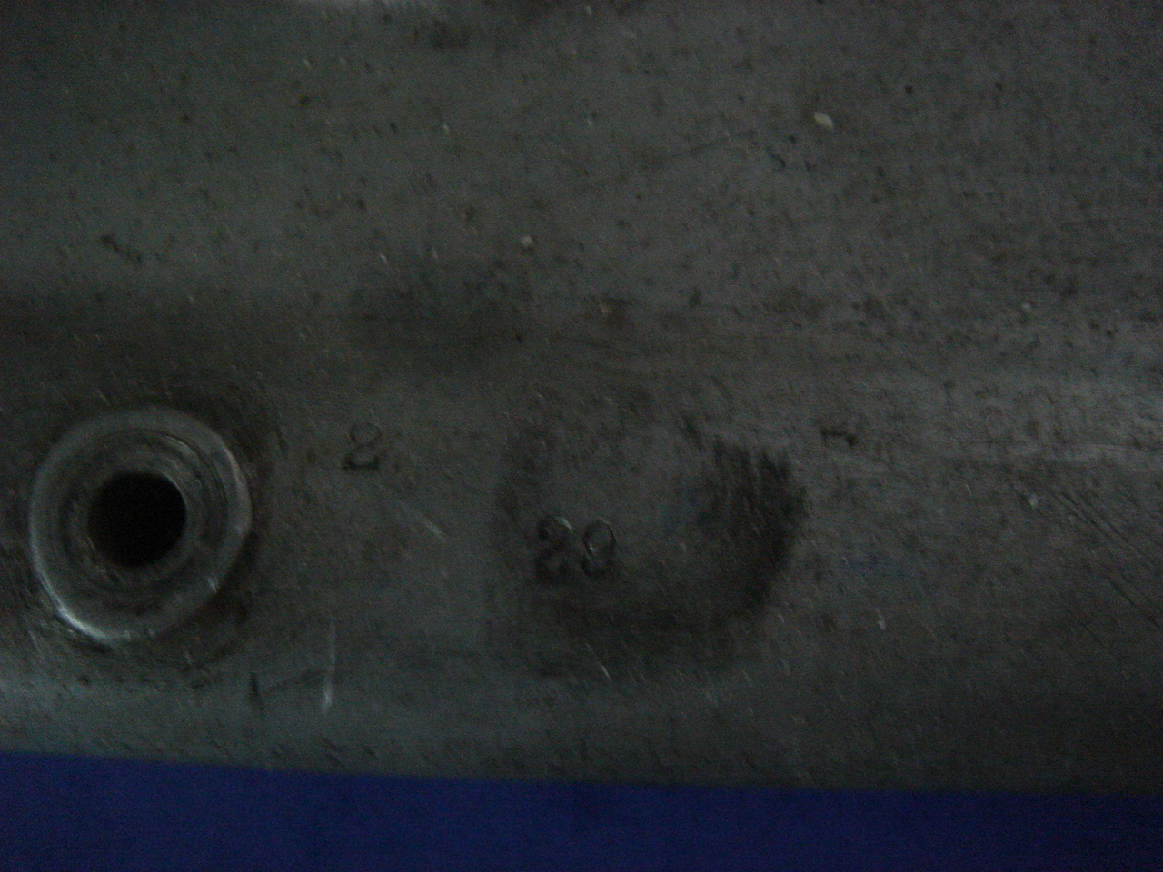

I have never seen "(4394)" so I really cannot comment further with any authority. I find it interesting to note that the car was purchased from Butti when the 1990 British Bugatti Register said it was owned by Dan Margulies with Butti as a prior owner. Does this mean Butti owned it twice? Why would Margulies buy it from Butti and then sell it back to him? Do we know who Butti bought it from? If it was actually found in a scrapyard, I'm sure we would all like to see those "as found" photographs which would surely exist for such a fantastic discovery.
I was told many years ago that the car was on frame no. 22 and that it had gearbox no. 29 and rear axle no. 21 (I hope I don't have those numbers reversed as they are off the top of my head.) I included them in my GP frame and component number list for many years, but when I updated it last year, David Sewell told me I should delete them as the car was a replica. I assumed he had seen the car and made this determination from personal observation. Certainly, his 1990 letter attached above is hardly confirmation of anything.
I would be delighted to learn that the car is chassis 4394, but nothing I have seen above confirms it.

Dearr Buchner and Sandy,
I understand your concern about Butti's cars.
It came back to him, because he had made a deal with Dan Margulies:he would exchange 4394 against another Bugatti.So the car has been the property of Dan Margulies for a while , but because Margulies did not give the other car ,a tribunal gave it back to Butti; this what I remember.
The car was advertised as Cholmondeley 4394.
Sandy is right concerning the numbers and here are the pictures attached: The car has the right numbers.
Among the experts who actually SAW the car :Rondoni, Sauzay, Hugh Conway (who probably saw it before restoration) nobody speaks of a fake , and I have other experts thinking it is the true one.Af riend of mine who is Expert for the french custom and who wrote a book on the Bugatti 35 Grand Prix de Lyon , does not suggest any abnomaly
Why would Raffaelli woul quote a non existing car ?
Anyway, again I suggest that if any one of you comes to France I will be very pleased to meet you
Sincerely
Frank Trepsat
