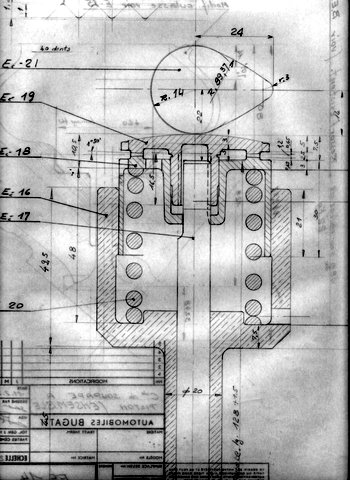

PostPosted: Tue Feb 24, 2009 3:54 pm
This is what they were waiting one month for.EC14 a quickly adjustable tappet.The old guard were not pleased with hairpin valvesprings and spent months trying to replace them.The solution was to make the guide act as support for the bucket.An expensive and complex solution to a non existant problem.
