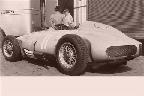

I was recently offered some photos of T251 Bugattis.One of which has the motor at the wrong end of the car ! :D Is this fine looking car an EMW [look at the lorry at left] I know that der bis der sehr clever German friends on the site so maybe they can help?
