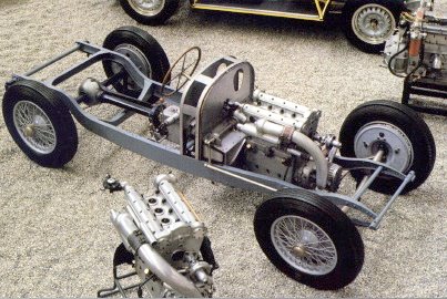

This rear axle does not look to be capable of transmitting more power than a T59
 Post subject: Re: Ettore Bugatti design considerations
PostPosted: Sat Jul 04, 2009 6:18 pm
There is some logic to slowly strengthening parts until they stop breaking.This is a sure way to make sure that the weight is kept to the minimum.The T35 gearbox is indeed based on the Brescia one.There was always so little information about the prototypes that we really do not know just how far they got with the development program.The big blower is a case in point.It worked well on the testbed but it seems that it was not tried on the car until Roland tried it at Molsheim in the early fifties.Then a special inlet manifold had to be made because nobody had realised that there was no space between the blower and the steering tie rod.The back axles broke consistantly on the T73 roadcar fitted with the T252 motor,even though they had maybe only 125 BHP to deal with.A new backaxle had to be designed,much like a T57 with a ribbed case.Obviously it is better to start a development such as this from where the factory left off,and all the T73c's today should have the big blower,later differential etc.Hugh Conway once told me that "this car needs a proper engineering based development program"Hopefully this is what we are now doing.Getting the engine right was clearly just the first step.
