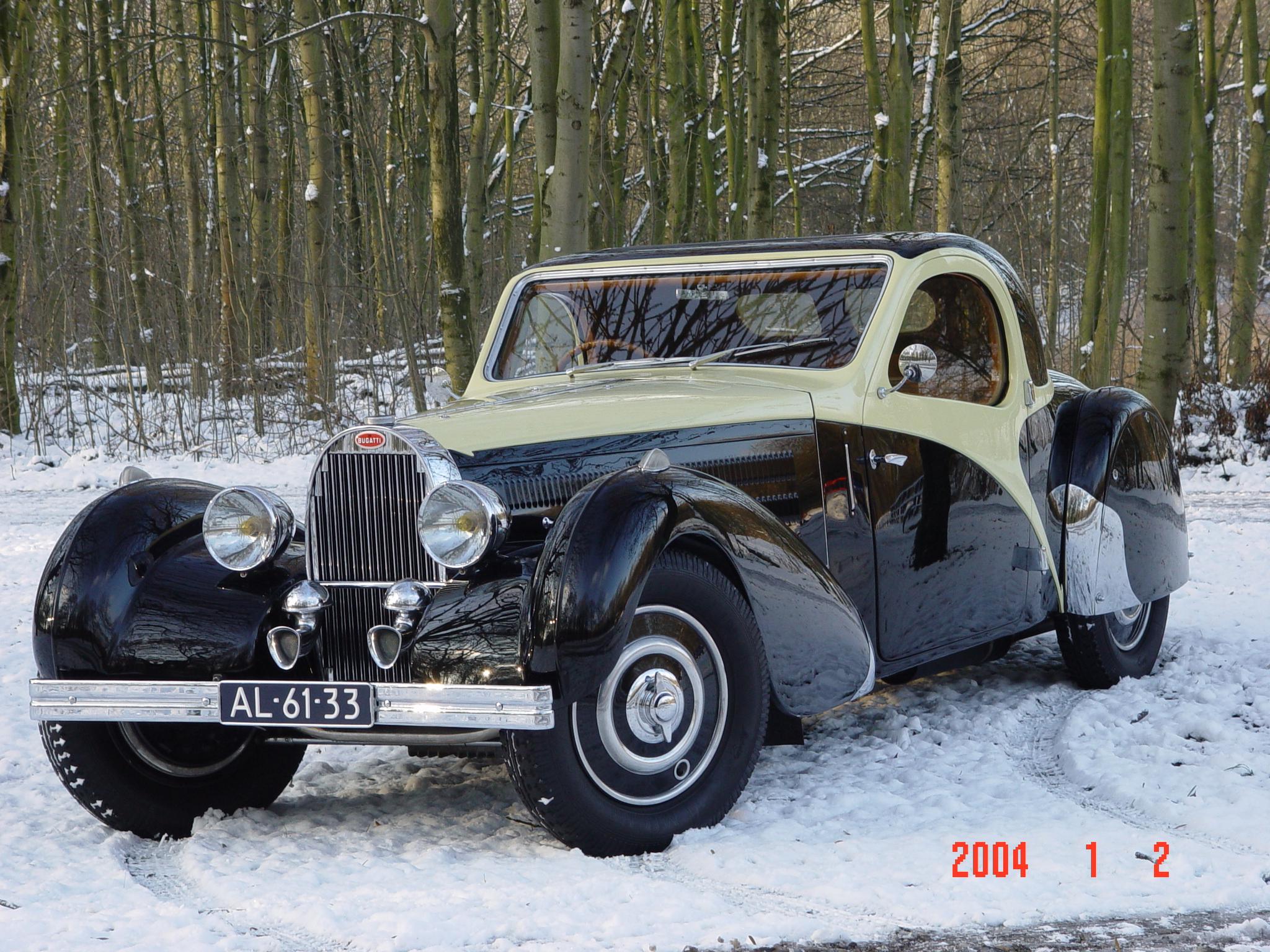

The picture of the above car is my own Atalante 57432 about 18 years ago around 1991 with Bernard Merian. However, it now has black rims on the wheel covers just as it originally had in 1936 (this is how I bought it). By the way, I have never seen this pic before.

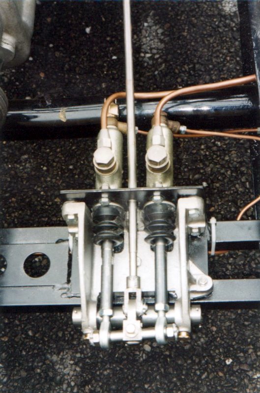

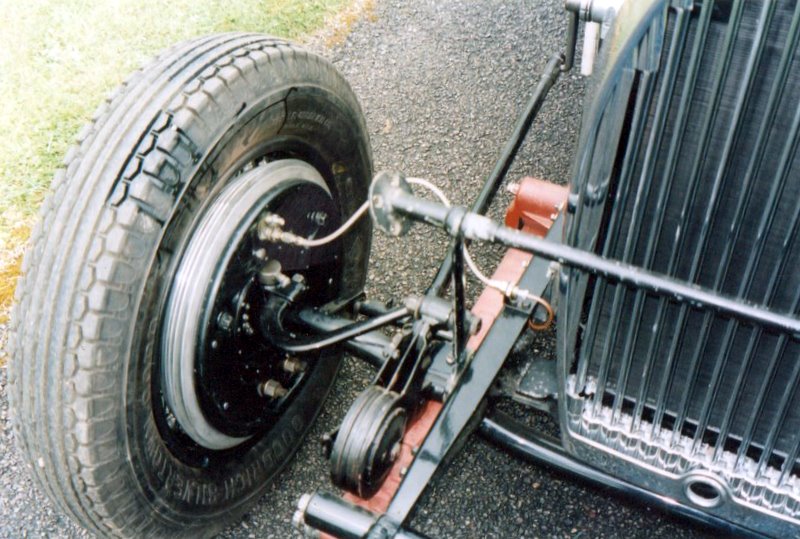

Fitting the modified Lockheed brakes to an early rigid engine T57 is not easy.I would like to see just how this was done in the factory.I converted a car from Japan to use a set of these special Lockheed/Bugatti brakes.I include some photos.The odd swingle tree arrangement is entirely mine own ! Using a T73 roadcar brake cylinder casting.The brakes worked fine but would have greatly benefited from a servo.A quite heavy shove was required to stop the car.

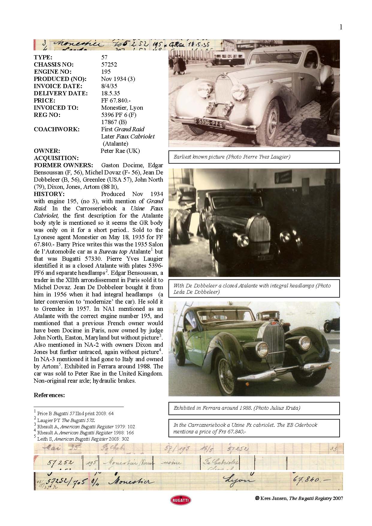

Herewith also a picture of my car with its present wheel covers, and a slightly corrected page from Vol II of our register.
I take it it has a type I engine? You can recognize it amongst others by the exhaust configuration: maybe you can send a picture of the outlet side?
