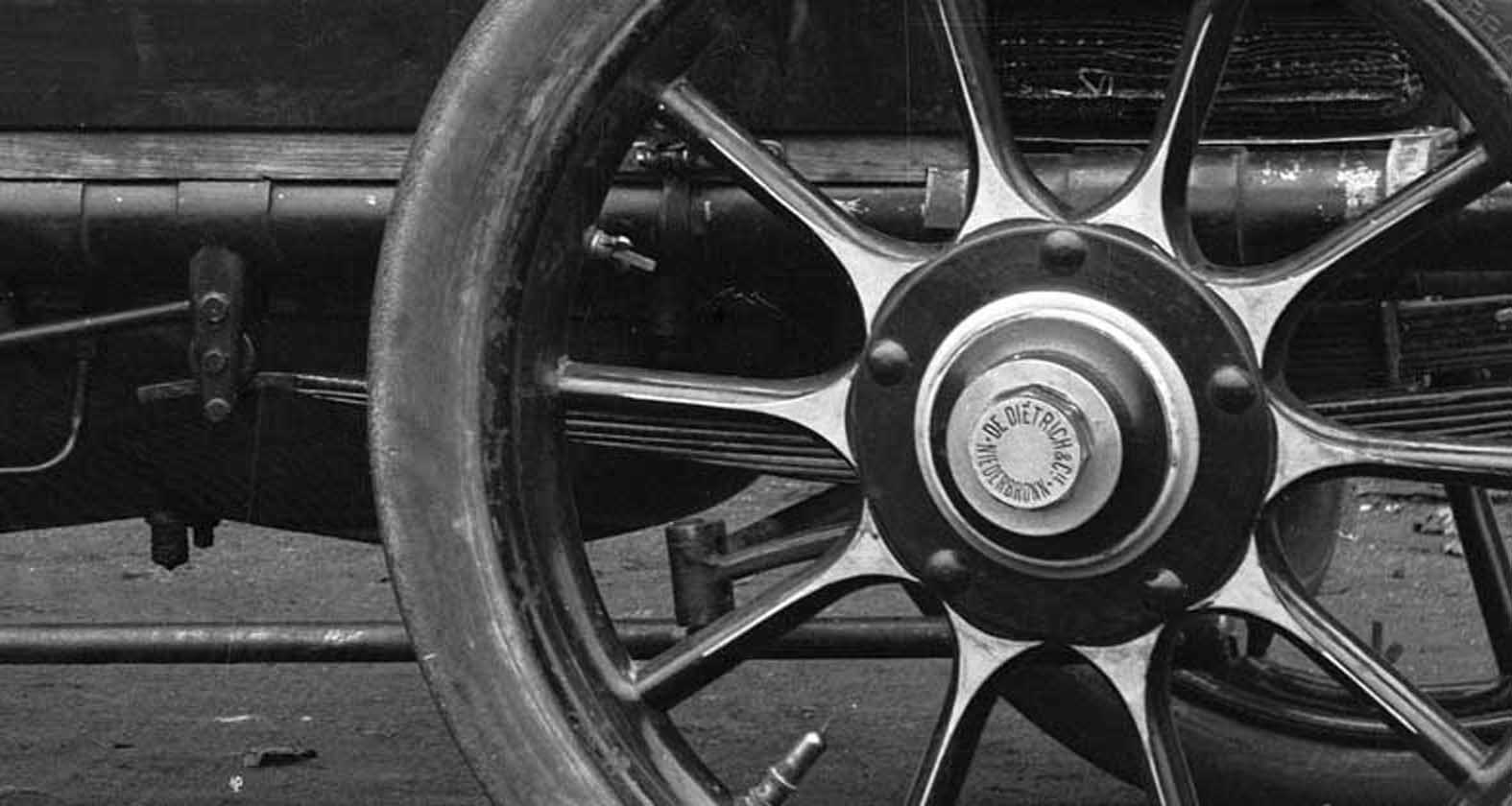

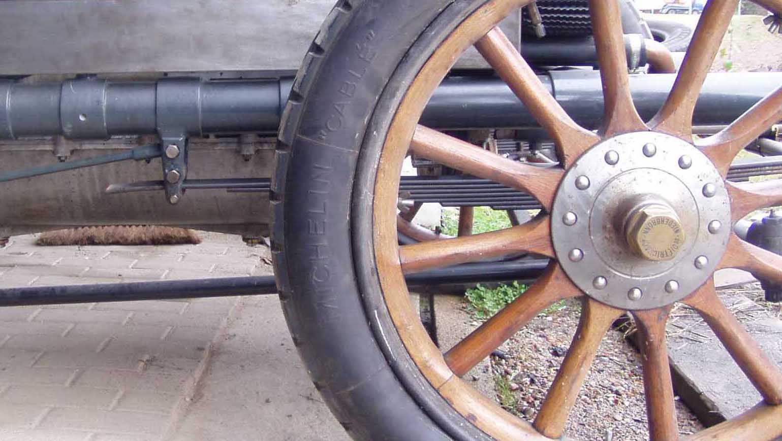

I do not know if this is made or original , but the spring is only 35 mm wide . The holes in the axel allow only 35 mm . And both eyes fit very good . So for the top leaf 35x5 looks not so good .
The reason I did start to ask for springsteel , is the Type 5 .
To use 35x10 in a T13 looks maybe strange , but what about 50x6 in a T5 with over 1000kg ? And Greg , you will love it , this one is made in England . Maybe one of the friends from thingfish with over 50 years Bugatti experience did it ?
The second radiator and the 15liter water tank between the first radiator and the cylinder is still missing . And the top of the spring is already straigt . So with the water tank and the second radiator it will bend up .
I think it is easy to see that this spring is far away from the original .

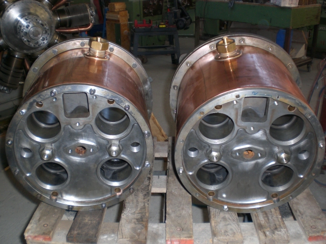

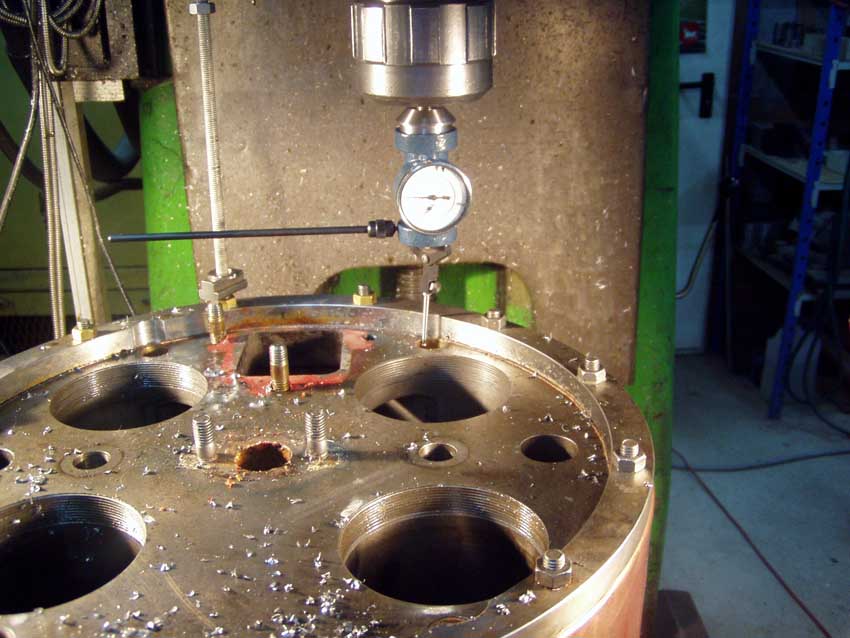

every part we make or change will be 100% to the drawing or if there is no drawing like in the fotos we have . For example . I got the cylinders and the top was just machined flat . Spark plugs sitting invisible in deep holes ( I still do not know why). I used fotos to machine the contour on top and bring the spark plugs to the right place .

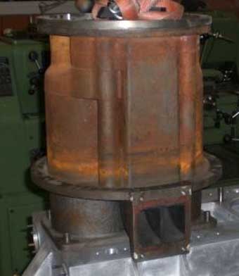

Original this contour is casted in, so what chance did I have to fix it ? Some is made CNC like all the radius .
