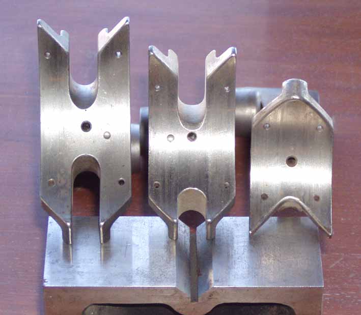

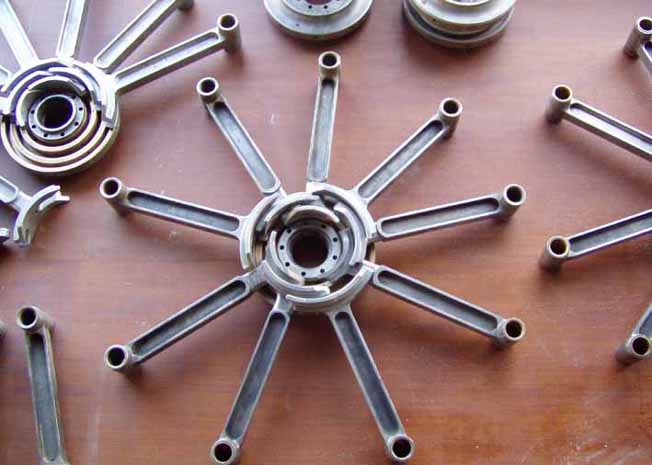

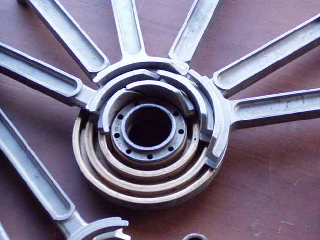

con rod system 110 Le Rhone and 120 Oberursel . Both engines have 9 cylinders and 15 liters .
What a strange way to make an engine.Very complicated and expensive too.I prefer the Wright Cyclone Master rod and slave rods.Used also by many other companies,including Bristol.But fascinating to see,so show us more please !

Normal Radial engines like the Wright Cyclone have a Master Rod and attached to the master rod the slave rods . All this engines have for every cylinder a different timing . Different timing for the valves and ignition . Because of this different timing , some cylinders are to hot and some are to cold . Only one cylinder has the accurate timing and temparature .So , the con rod system from a Le Rhone and Oberursel is much better , same timing for all cylinders .
I cannot argue with you on a subject about which I know very little,however I feel that I should point out that thousands of these " problematic" wright cyclone engines droned out over europe night after night between 1942 and 1945.I do not recall any discussion about poor timing !

for example , a 5 cylinder radial engine . Top cylinder is the master rod cylinder , all timing is ok . First cylinder left ignition plus 4 degrees , second cylinder left 8 degrees plus . First cylinder right 4 degrees minus , second cylinder right 8 degrees minus . A 5 cylinder radial is not so bad like a 9 cylinder radial . It was possible because the compresion ratio is from 4:1 to 6,5:1 . Maximum ref. from 2200 to 2600 . Hours bevore overhoul 600 to 1000 . And after every flight the mechanics did look after the engine .
