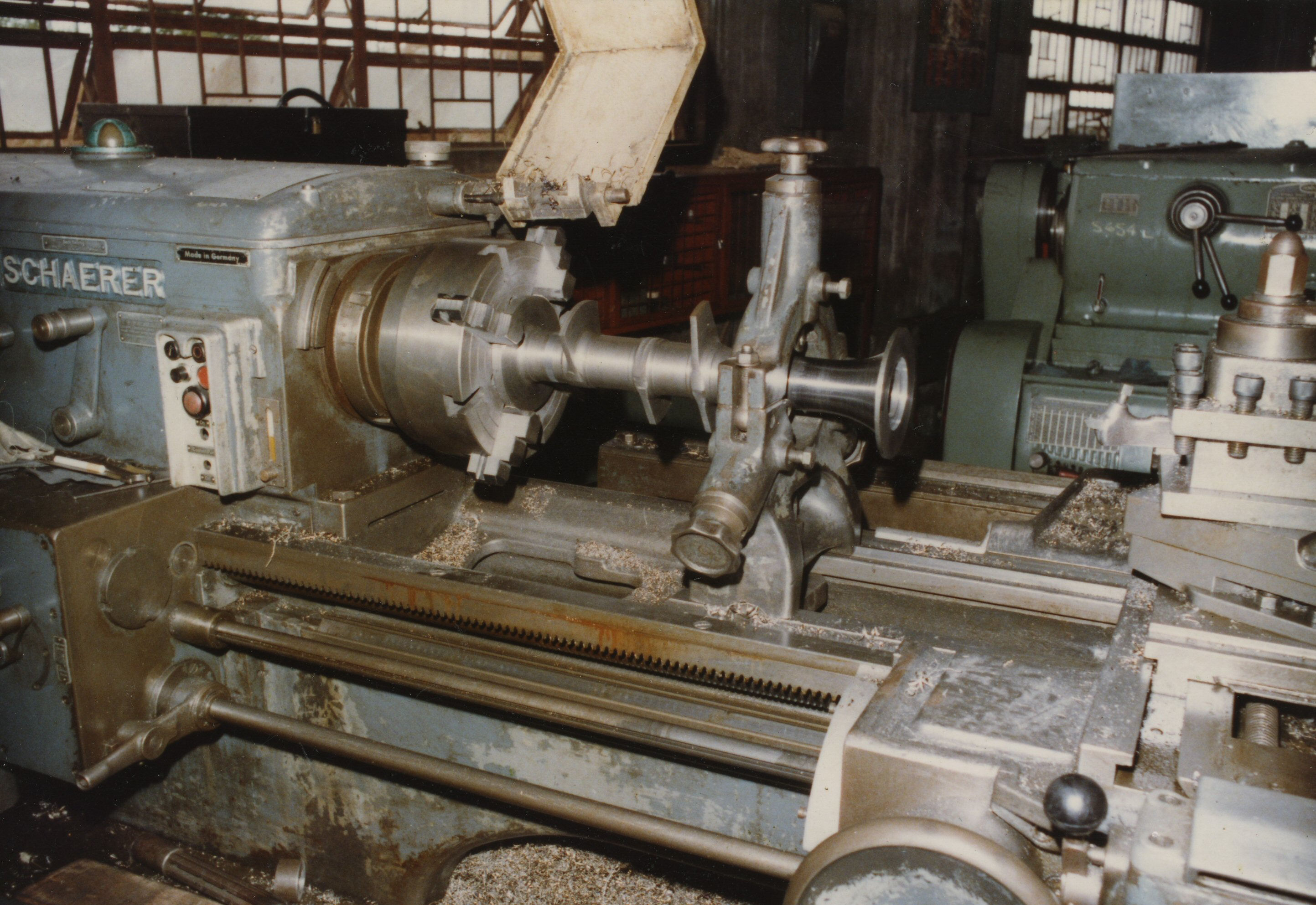

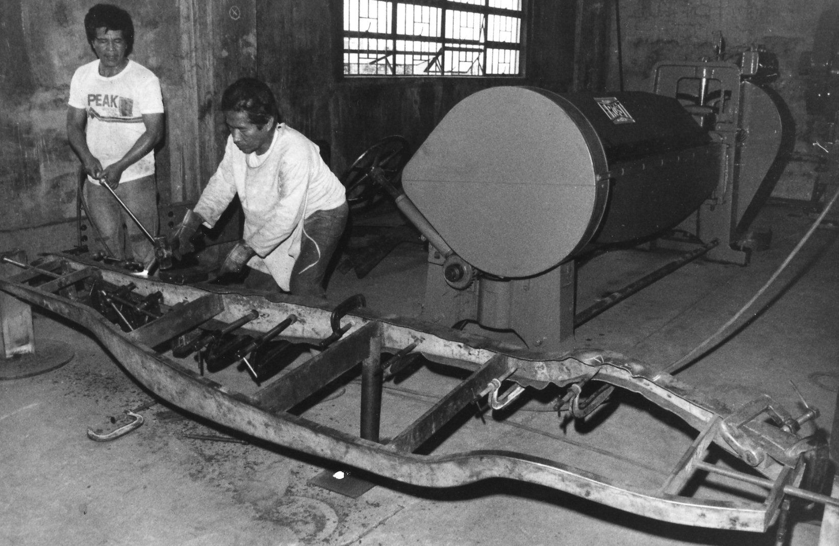

Regarding the dimensions of what were presented to me as original chassis, there was up to 5mm difference in some of the detailed dimensions. I would be amazed if Molsheim hammered hot sheet steel around formers to produce their chassis, I always thought that they went out to specialists to have them pressed out in 150ton presses much as Gino Hoskins makes them today. Changes in dies or bending in plan might account for dimensional discrepancies. Incidentially I tried to make chassis in the Phillipines years ago see photos (if they reproduce) but they required a tremendous amount of oxygen and the metal went each way and everyway. With an ambient temperature of already 40degs. the workers didn't like the process too much. They are still in the Phillipines in the jungle somewhere should anybody like to retrieve them! I remember that the 4mm steel was purchased from a shipyard where they unrolled the required length from a huge roll that must have weighed many tons.
The late Alan Wragg in the UK used to keep chassis-making for the cold winter months. I now live in Thailand and have just made 4 chassis by laser-cutting the blanks very accurately, folding the straight bits in a press and welding in the curved parts of the flange. Once fettled they look superb - as good as Gino's creations and cost only a fraction.
I also enclose photos of front axles that I also attempted to make in the Philippines. The turned blanks were bored in a gun drill and the ends forged. Again heat was the problem as it was difficult to get the bends in the ends the same without deforming the 'tube'.
File comment: axle, stage 1
