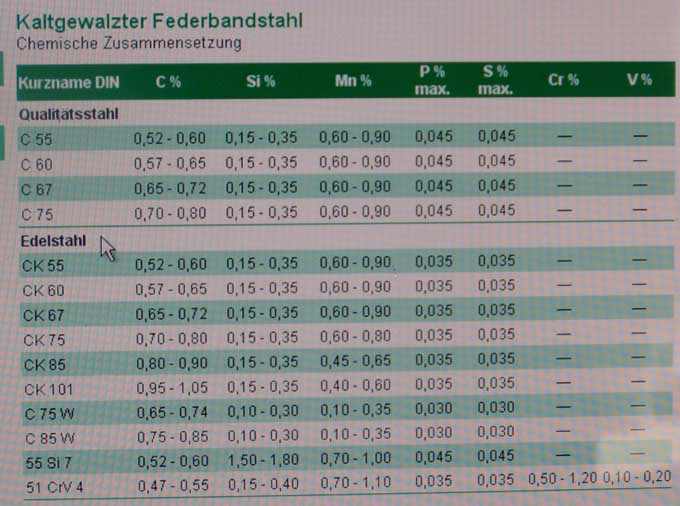

I do not know how many chemical analysis you made from original parts ? But for all parts we made for aircraft including leave springs I made one . Because in the end an aircraft inspector has to sign for and likes to see some papers . The only real differend is the carbon .
If I buy a bigger amount like 1000kg and more , it is very much the same price like normal construction steel. So the differend can not be so big .
Udo, what you mention is normal "quality" spring steel, which is at the rather lower end of available spring steels. Indeed this contains no alloying elements and of course one can use that.
In contrast, what Bugwrench referred to was "high-grade" spring steel. Something that a real engineer would always choose: the best(!) material available for an individual application.
BTW, Molsheim also used the "high-grade" type of spring steel. Of course, you can only know that if you have access to the real things.

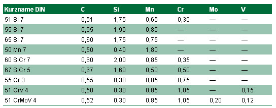

If you post pictures of websites, you should post all available informations and not those that help your argument. BTW, there are even more springs steels as on the website of HMC Meyer in Dusseldorf :

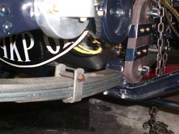

Thank you guys for the answers . But I do not realy look for ready made leave springs . I look for the material in 5 to 6 meter long rods . The guy who made the springs for the type 5 made a mistake . The springs are made from 50mmx6,4mm .The springs are getting a bow up , much to small . The original are made from 50x10 and 50x8 . So I like to make the springs and bring the car to the right level . Spring steel is very cheap carbon steel , nothing spezial, but nobody needs it .

today I did look at a T13 . Front springs are made from 35mm x 6mm and 35mm x 10mm
 Post subject: Re: Spring Steel
PostPosted: Tue Nov 09, 2010 9:48 pm
A competent engineer who is aware of the size and weight of a Brescia will conclude that something is seriously wrong with 10mm front spring leafs.
Front springs leafs for the Brescia were 1x5.0mm plus 5x4.5mm for the two seater chassis and 1x6.0mm plus 5x5.0mm for the 3-4 seater chassis.
So I recommend to either check your eyes, your calipers or choose a real Molsheim produced and properly maintained/restored Brescia to verify the front spring leaf thickness.
PostPosted: Wed Nov 10, 2010 4:06 pm
Do not wory about may eyes or calipers , I only use the latest Mitutoyo . And the best engineer has sometimes no chance if ..... I remember Lazarus did say one time , Bugatti made many silly things .Top leave 35x10
