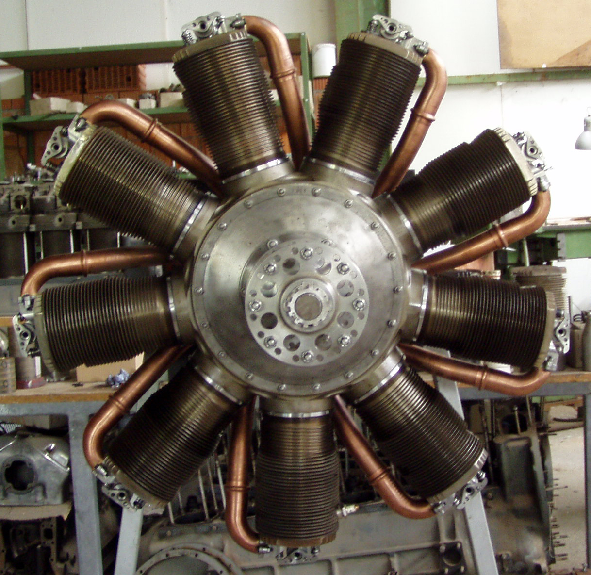

One reason to wheel the ends . To forge I have to send the axles to a forging company, wheeling I can do in my place .Maybe I still do not anderstand this front axle from 1920 , because we only build aircrafts and aircraft engines like this one .

and also Jaguar engines I see! Nice bit of plumbing on the rotary or is it a radial? I saw many of these engines recently [Gnome et Rhone] at the museum Safran near Paris.Just full of Hispano and other aero engines,quite beautiful.

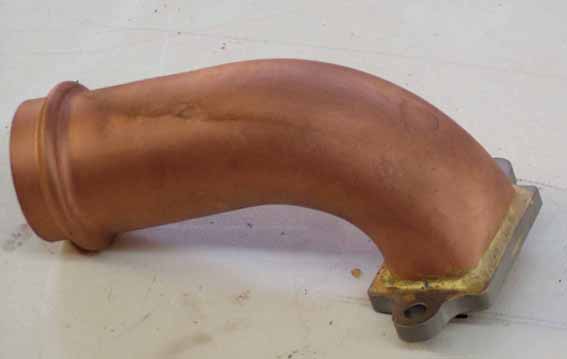

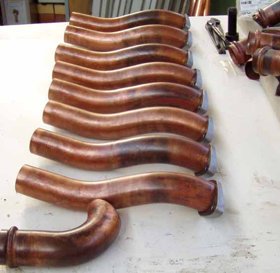

It is a Oberursel Rotary , coppy from the Le Rhone 1916 . This one is brand new , scratch build . The plumbing is very diffycult . We are the only company today , bulding this kind of engines and suply parts .
