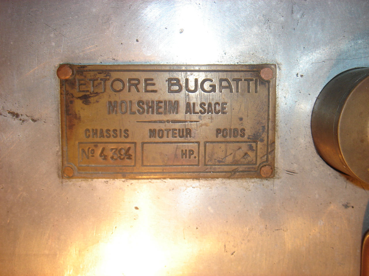

No one can express any opinion without at least proper pictures but much better a detailed inspection by one of the very few experts.
The very bad out of focus picture of the chassis plate is a bad start and easily leads to negative conclusions.

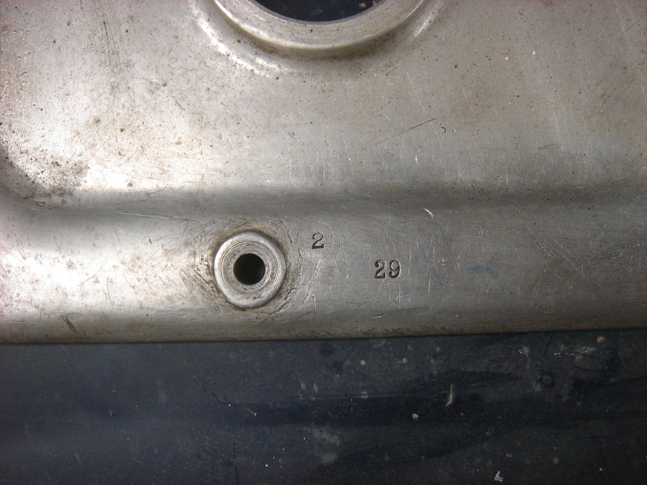

The obviously removed and restamped number on the gearbox lid does not help either!

her you will find a sharper wiew of the chassis plate of my car, and also a new picture of my gear box cover, cleaned out of grease .

So far, we have seen photos of the no. 29 gearbox LID which Bart thinks was restamped; the chassis plate whose "4394" stamp fonts are incorrect and a rear axle stamped no. 21...the numbers for which may or may not be okay, it is difficult to say for sure. The evidence is pretty think on the ground, as they say. I also do not think that Jean (Lazarus) has committed himself, one way or the other (I think his range was 1-100% Molsheim), nor do I think that Rondoni's statement...that the car is 70% original and it "fits well" with the number 4394...puts him down in the "This car is DEFINITELY 4394 camp.
