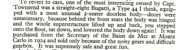

Found it. Not a type 44 as written but a 30, originating from Monte Carlo.
Yes Christian, the picture last sent by you is the same car as sent by me before. Merci beaucoup et salut.

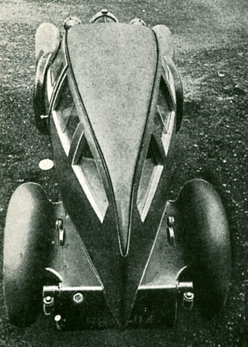

Yesterday I wrote : "Getting back to the T38, wasn't there a similar 4-door body on either a T38 or T44 chassis?"
I was referring to this car ; my memory is playing tricks again, this car is featured in both Magnum and Hucke/Kruta yet I thought it was a 4 door. Odd.
Jacobug I am fascinated to hear this car had no doors. I'm trying to figure out how the rear-body would hinge up. Like a Lamborghini Muira's engine cover but including the area where the doors would normally be? Another thing, that windscreen, or at least the bit that can be seen, also looks a little strange, but I'm not sure why.
Fascinating, thanks.
I have more photgraphs of this one, the whole center section, including windscreen, hinges to the rear, There are small cut-outs to ease access a bit. Can't find the photographs at the moment though. This car is sometimes mistakenly indicated as a T44, is in fact a T38.
The windscreen looks strange, because it is attached to the doors.

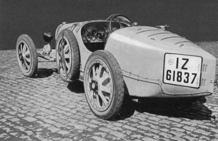

thingfish wrote:
What licence plate is on the car ? Anyone out there with access to a more sharper image?
To me it looks like a German plate ... IZ xx837 (?)
That would have to be IZ 61837

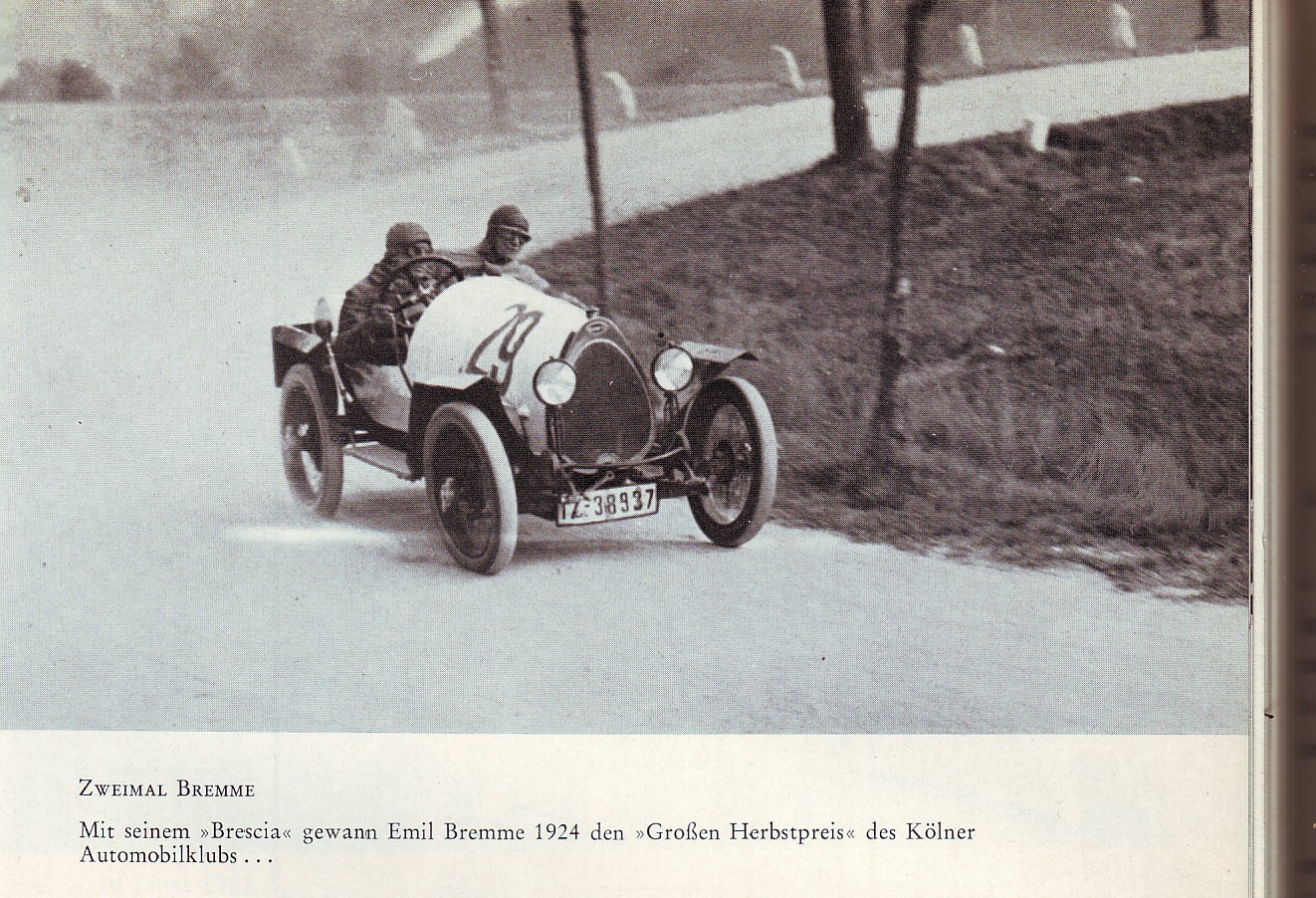

I think this car might have been owned by Emil Bremme, a well known Bugatti driver in the twenties. Herewith you will find a picture of him in his first Bugatti with numberplate TZ 38937 .. This could be the same number is shown on the small type 35 fixed head.
I do not know whether it the same car is, but it could be the same number (IZ 61837).
Look at the headlight in the second picture (besides the license itself) for confirmation.

Not correct. The car ist NOT #4878, which looked completely different.
It is Bremme's earlier T35 #4393, which he substituted in May 1927 against a T35B (#4842 or #4853, with the other one went to Eckhart Graf von Kalnein). A photo from my archive showing #4393 has been posted earlier in this thread, clearly showing the registration IZ-61837, wich can also be seen on the opening photo of this thread. When buying the T35B he converted the old T35 into a road car with coupé bodywork. Only in 1928 be substituted the coupé against another T35B (#4878) which received the Bachmann GS body. Strange, because he stopped racing #4842/4853 already at the end of 1927, so why not converting this one into a road car? But probably he intended to resume racing later, because he sold #4842/4853 only as late as 1930 (to Ernst-Günther Burggaller).
Reason for the wrong identification may be the registration, which on the 2nd photo (that from the Trust) reads "IY-2....", with the registration of #4878 indeed was IY-21166. The background is simply administrational, the Rhine Province until 1927 had prefix "IZ", after that it was divided into Cologne (still "IZ") and Düsseldorf (now "IY"). therefore Bremme, who lived at Barmen (Wuppertal) hat to re-register his cars from "IZ" to "IY". The 2nd photo has been taken later than the 1st one, with re-registration in between.
