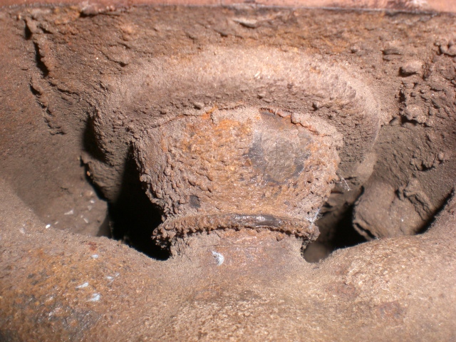

my experience, this manuals are worthless . What kind of info can you use ? What info you are looking for ? To pull the spark plug cup out , weld something to the inside , and pull it out . Make a new one with a groove for a puller . Use a modern o-ring .

It would be sensible to repeat here that it is safer to machine out the old plug cups.Certainly not a job to do with the engine in situ.Welding to an old cup and pulling to remove the old cup can remove a large part of the block down to the combustion chamber.Better to forget removal,and press in a stainless steel repair cup inside the old one.There was, famously,a stainless steel egg cup which fitted perfectly ! Silicon sealing an old block is also a useful job to do if the block is removed for any reason.This can stop small cracks from becoming a problem before they start.

if you weld all the way around inside the cup , the cup shrinks if it cools down .Heat up the bottom part , and you can take the cup off . Use the spark plug hole to help getting it out .

I think that using the spark plug hole will not work as the spark plug threat is one piece with the combustion chamber but not with the cup.
Also the original cups don't have a threat for the plug but seem to fit somehow around the spark plug hole dome on the combustion chamber.

the spark plug threat is one piece with the combustion camber . This is why you can use it . Need a drawing ?

The T57 cylinderhead plug boss area is too fragile to take a chance on breaking it off.It is STRONGLY advised not to try to remove the cap by pushing against the plug boss.

after welding ( not gas welding ) inside the cup , you can take it off easy .

I understood now how to remove them but how about re-installing new ones.
Do you think that they can be pulled in by screwing a threat bolt into the spark plug hole?
Still I think that turning new cup inserts that would fit over the existing ones might be the better solution for a not disassembled engine.
Minime
 Post subject: Re: T57 Technical information
PostPosted: Thu Apr 26, 2012 11:47 pm
I do not really pull them in . I use top and bottom a modern o-ring and you can press them in with very little force . On top , inside a small edge , and you can pull them out easily any time .

I have owned four T57 cylinder blocks, every one of which had damaged cylinderheads where people had tried to remove the plug cups.A repair cup loosely fitted inside the original with a modern Locktite is the safest way to sort out this problem.

I do support Lazarus here. The Udo method has a guaranteed 50% failure rate. Never ever try to pull the old cup out but machine it out. There is a very useful T57 workshop manual available form the BOC that describes three different methods for repairing these leaks. Although this manual has been written a long time ago it still contains a lot of good general information about the T57 engine.
Do follow the suggestion of Lazarus if you have only one minor leak and you are reluctant to disassemble of the engine.
