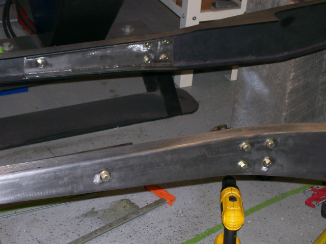

Marek - though "inferior" I have successfully fabricated a frame from that drawing....even solved the conflicting radius issue in the back. E-mail me and I can tell you what I know about it.....
