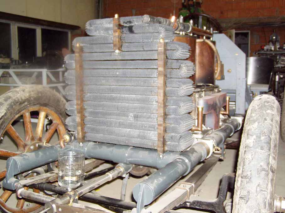

For the first tests to runn the type 5 engine I did use a small electric water pump , but the engine was to hot after some minutes . Today I did use a bigger pump , still the same . So I started to investigate the radiator and got a surprise .
The radiator contains maximum 1 liter water !
Flow rate ,maximum 1 liter in 30 second !
What company made this radiator ?
regards Udolahr

PostPosted: Thu May 27, 2010 10:20 am
I belive the bronce valve seats are made in a machine shop. And the radiator in a radiator shop .
Every part in this engine , I had to make new or machine it to fit .
So you are absolutly right with your comment , "It seems that a high percentage of the parts are just wrong."
I am not so sure about a " Mock up " , because for a Mock up I do not build camshafts and crankshaft bearings and so on .

About the radiator:
The type 5 was the one with tubular frame members, which held the coolant as well, right? The enormous surface of the tubular frame could definately help dissipate heat.

today I did check the weight , this radiator has 45 kg . How is this possible ?

I just made some calculations . It is a copper pipe with 8mm autside and 5.6mm inside .The radiator should contain 2.5 litter , what is still a joke for that size engine .
Best of all the 10 copper tubes are not in one piece . Each tube is soldered tugether from 15 smaler tubes . Each tube is about 65 cm long . So we have 150 connctions soldered together :wink: Yes 150 . I belive that some soldered connections are filled up with tin . So only some tubes are open , and most of them are blocked . This radiator is only good for display . For running the engine it is useless .
Who has experience with this kind of radiator ?

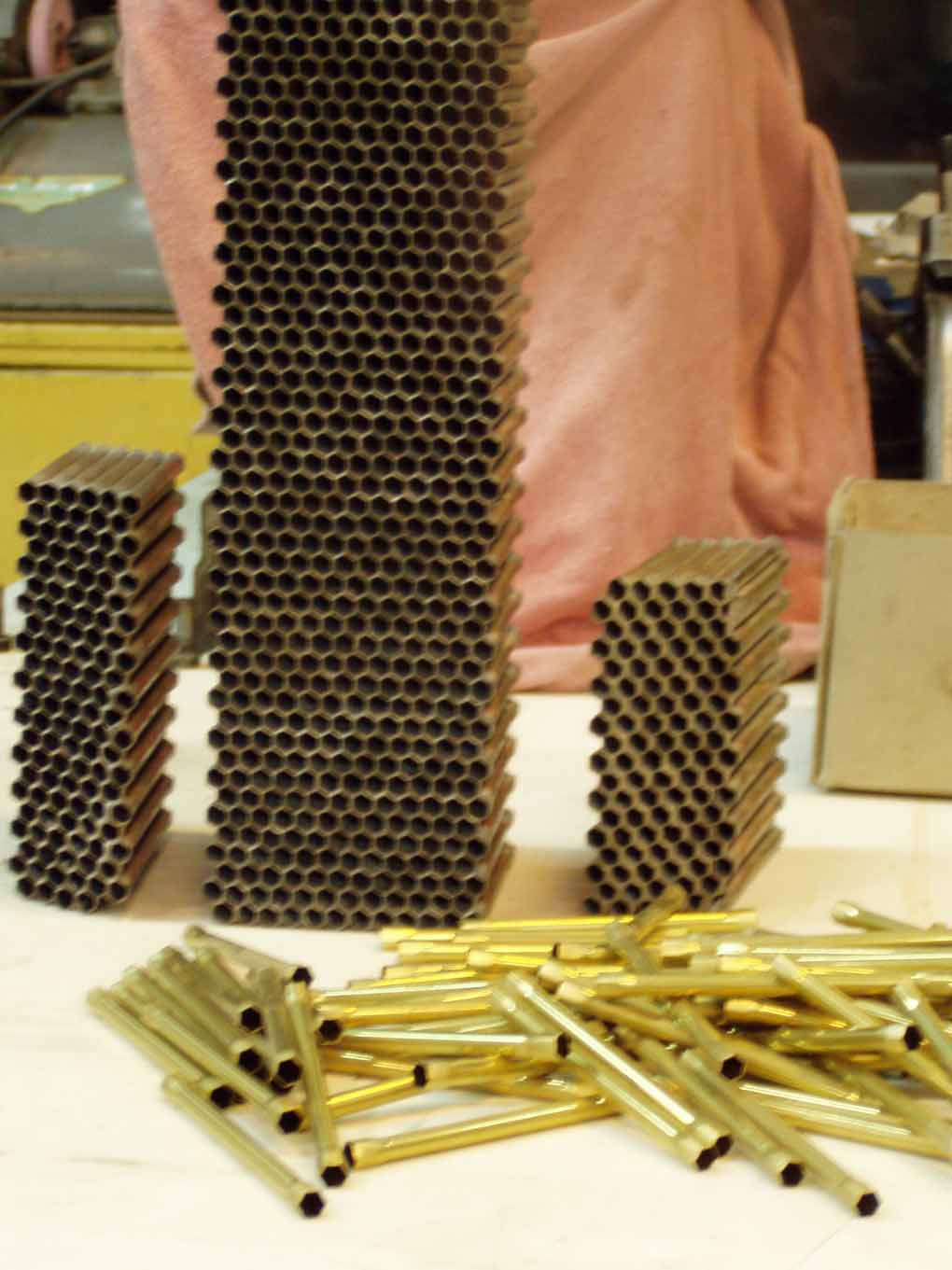

For many years I am building radiators , most time honeycomb . For example , radiators for the 15 liter Mercedes aircraft engine . Or the 1908 Wright Flyers .So I know how the water flow-through should be for a 13 liter engine .The bad part with the Type 5 engine is , that the exaust manyfold is inside the water jacket .
 Post subject: Re: Who made this Radiator ?
PostPosted: Sun May 30, 2010 7:43 am
I really like these radiators. How do you solder them together? Using soldering paste, then heat up the whole construction in an oven or by flame?
PostPosted: Sun May 30, 2010 12:27 pm
First you buy brass tubing 1/4 inch (6,35mm) autside diameter and 0,2mm wall thickness , and 4 to 6 meter long .Sometimes not easy to get , so you need a company making it for you . You cut the pieces with a cutting blade .You need some speed and many very fine tooth . Best is to cut 10 or 15 at the time . Press the hexagons at both sides at the same time . Put all the pieces very tight together in a wooden frame . You need a bath with soldering fluid ( acid ), put the frame with all the tubes about 2cm deep in to the acid for some secunds . Next , you need a bath with liquid tin , lay the frame about 8mm to 10mm deep in and wait , so all the tubes have the right temparature . And you do it with both sides . sounds very easy , but make the first one !
