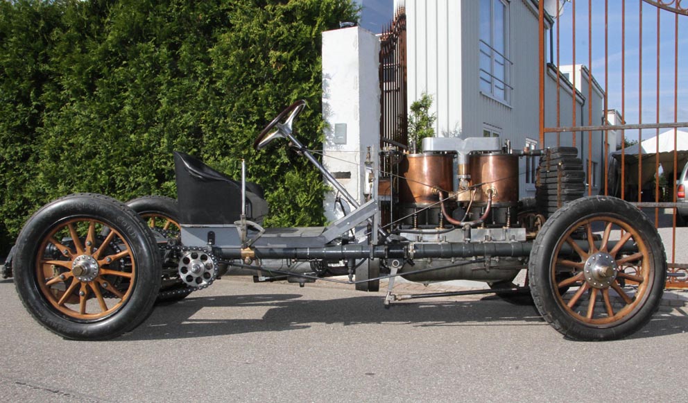

The car is the first time after over 15 years almost complete and drivable . Still need some small changes .
Baron Eugene de Dietrich ordered in 1902 , 2 Type 5 from Bugatti for the Paris - Madrid race . There is no information what happened with this 2 cars after 1905 . The last info we found was a advertisement in a newspaper , the German "Automobil Zeitung" in 1905 . The car was for sale in Straßburg for 15 000 RM . Baron Gilbert de Dietrich started this project together with Uwe Hucke in England over 15 years ago .
It is the first real race car Bugatti made . And the biggest engine he made . Today it is the oldest Bugatti in the world .

I am surprised there are so little pre-1909 Bugattis left. (Dietrich, Hermes, etc)
Anyhow. The 1903 Paris-Madrid race was a dangerous one. Bugatti did not participate due to scrutineering problems.
I guess you are the only one to answer this question: What is the car like? How does it feel? Would you do a Paris-Madrid race with it?

PostPosted: Sun Jun 15, 2014 2:12 pm
