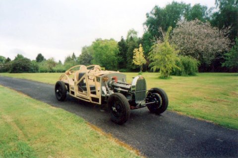

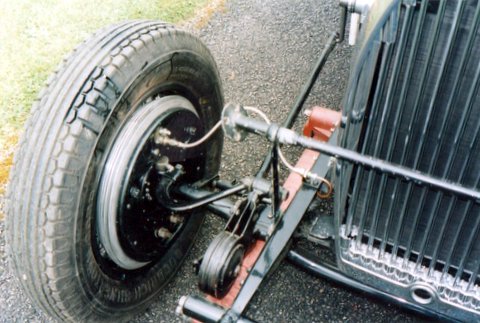

There are two completely different hydraulic brake systems for T57 Bugatti.The original "aftermarket" Lockheed system has modified lockheed steel backplates with rivited adaptors to fit the Bugatti stubaxles.Bugatti then made his own more attractive aluminium parts.The japanese t57 which I converted has the original lockheed system.
 Post subject: Re: T57 brake
PostPosted: Fri Jun 15, 2012 8:25 pm
do you have fotos ? Also from wheel and master cylider ?
PostPosted: Sat Jun 16, 2012 7:24 am
yes
PostPosted: Sat Jun 16, 2012 2:10 pm
is the black back plate steel ?
