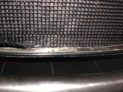

there is no need for this holes to find the center line .
