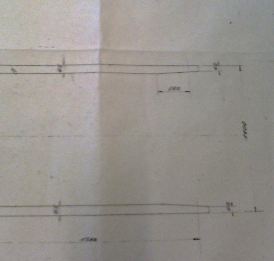

PostPosted: Sat Jul 16, 2011 8:37 pm
Your not reading the drawing properly - the front is parallel, The side rails have a 4 degree taper but the 512 measurement is taken 530 mm from the front - whereas the angle change on the outide face of the frame is 580 mm back from the front. This is why your measurements are wrong.
 Post subject: Re: Chassis drawings
PostPosted: Sat Jul 16, 2011 9:18 pm
so it is a optical illusion . If you look at the foto I did post , it looks like the front end opens to the front .
PostPosted: Sun Jul 17, 2011 7:52 am
Photos only help in a relative way. Perspective can mess things up badly.
PostPosted: Sat Jul 30, 2011 12:34 pm
It looks like Greg is wrong , there is no taper at the end of the Royale chassis . In the drawing it tapers from 65mm to 45mm , but only in the drawing .
Nobody has a Royale chassis at home ? :wink:
PostPosted: Sat Jul 30, 2011 7:21 pm
I don't even know what you are talking about now.
PostPosted: Sat Jul 30, 2011 9:37 pm
top view , Royale chassis drawing . End tapers from 65 mm to 45 mm .
