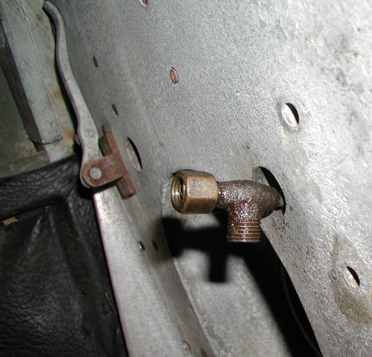

On the passenger side of the cast aluminum bulkhead on my car I have this small steel fitting. It is
identical to the one on 4486 (see photo) though mine no longer has the lever. It looks as though it pulls a cable, but what would this cable do and why is it mounted under the dash?
It is the handle to operate the valve in the exhaust system by means of a cable.
Below this handle you will find either a small pulley or at least the tiny holes for fitting this pulley on the chassis rail.

Bugwrench, thanks, that makes sense. Does anyone have information on the original exhaust cut-out?
