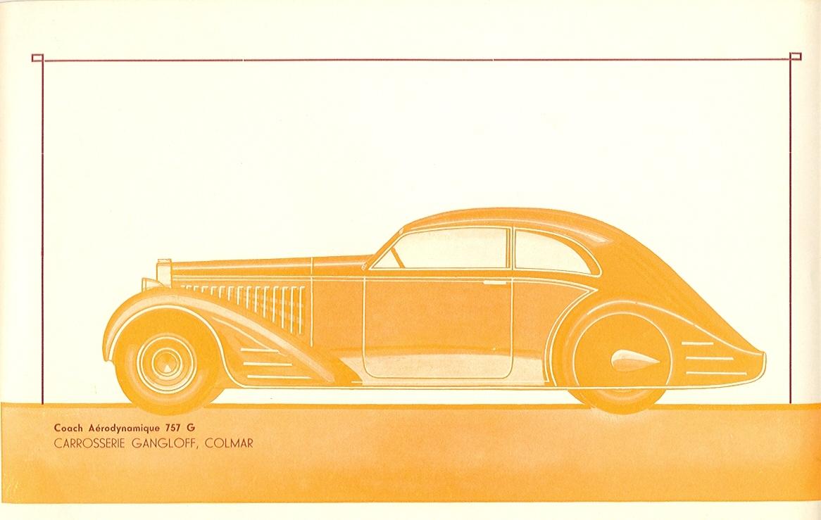

File comment: Herewith the 1935 Ganloff c atalogue showing a very similar car

Haje could be correct, Pierre-Yves Laugier certainly believes this car to be 57149/engine 55, first(?) registration : 675-BN 2.
Bugatti 57 Sport by Pierre-Yves Laugier ; Tome I ; pagination 24-29.
