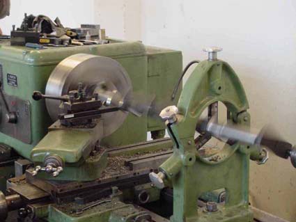

Drilling 5mm holes in a hardened Brescia crankshaft . Drills up to 50cm long , especially made for this jop . To have a more modern oil system .

last 5mm hole

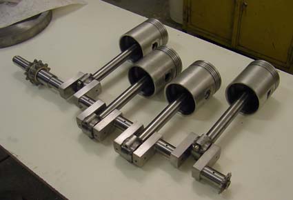

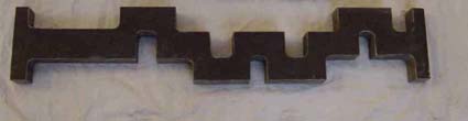

I made this Wright 1908 crankshaft from 42crmo4 .The worst material to drill long 5 mm holes . The crankshaft is 1 meter long .The old design drill bit for this kind of long holes has a tip with only one knife , but it takes houers to drill the hole . The new design is much faster .

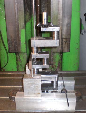

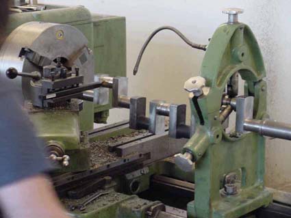

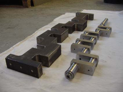

Another question, I am learning.
I see the piece of steel you made the crankshaft from. When you start to machine, will internal stresses that are relieved due to the removal of material, bend the workpiece? And how to counteract for that? Work your way to the final dimensions slowly?
 Post subject: Re: Brescia Crankshaft
PostPosted: Sun Oct 10, 2010 12:42 am
for a 4 cylinder you buy a rectangular piece of steel , for 6 and 8 cylinder you need a round piece of steel . For a 4 cylinder you start with a milling machine .After the crankshaft is 70 % ready , the crankshaft need head treadment, to get the tension aut . If the crankshaft is to much aut of shape you have to straighten it with a hydraulic press .After 90 % ready , again head treadment to get the tension aut and to bring the steel to 120 kg to the square mm .

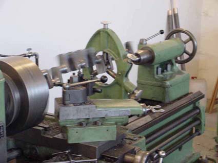

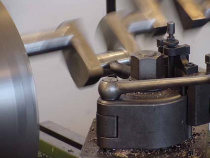

PostPosted: Sun Oct 10, 2010 12:47 am

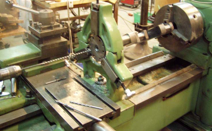

This is a Wright 1903 crankshaft , 1 meter long and the journals have only 32mm diameter . So very long and skinny .Most difficult one to make . 1903 with 5 main bearings .At the end the crankshaft is so unstable , I can take off in one go max 0,5mm
How long is the hole in your cambox ? The longest hole we drill in alluminium , is in our diesel aircraft engine , 8mm diameter and 520 mm long .
For drilling the big end jounals , I build the drill bits myself . With a very short head , 4 to 5 cm spiral and after the spiral , 0,05mm smaler in diameter . Sometimes this drill are up to 1 meter long .
