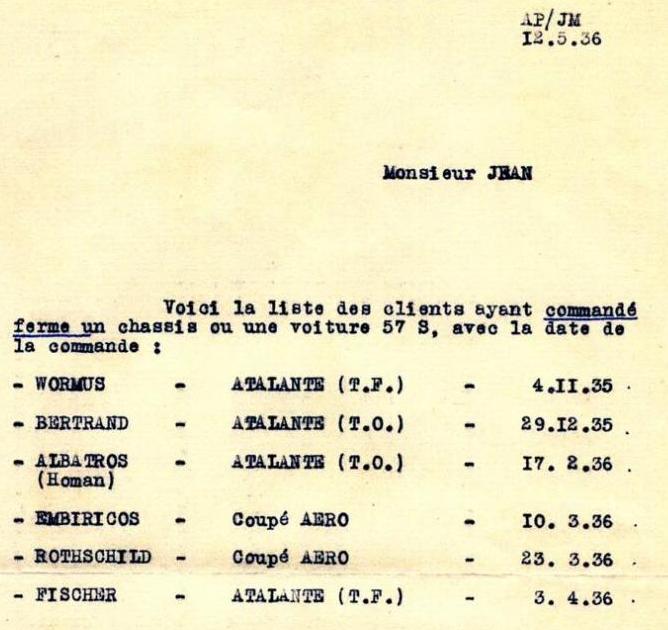

Could anyone explain to me why on the Register the chassis #57453 and #57374 are listed as "Coupe Aero" and not "Atlantic"? I know for a fact Rothschild / Williamson car is the most original Atlantic there is known but still it's listed with another name. And how about 57374?

I've always known Rotschild's as one of the last 3 remaining Atlantics to existance. It's not? Or is it Embiricos' car one of the missing Atlantics too and the Coupe Aero is the factory name for Atlantic? I'm a bit confused, now.
And how about the Aerolithe connection I've talked about?

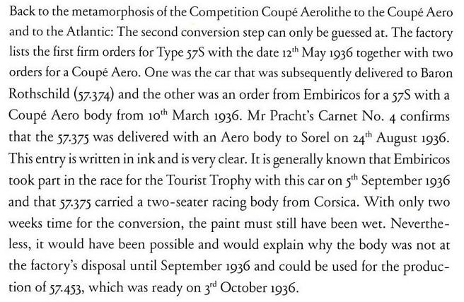

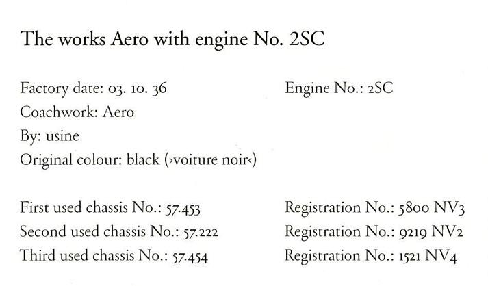

Here is a small cutout, perhaps continues to help that ...
and see topic: viewtopic.php?f=1&t=1269

Also read this:
http://www.bugattibuilder.com/articles/ ... o_EXK6.htm
