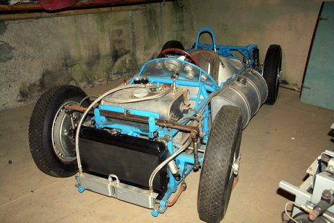

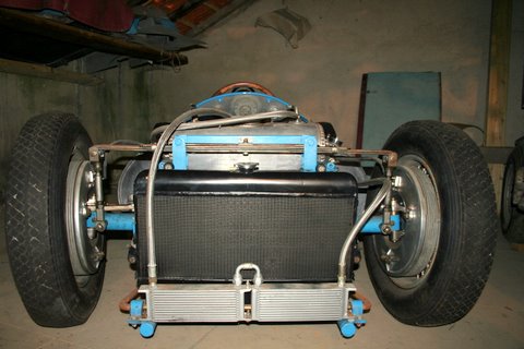

Just so you know that work continues on the T251 here is john Underwoods nice radiator fitted today for the first time.It almost went straight on!Now on with the motor.

Looks frightning. Do you plan on leading the coolant through the chassis tubes?
 Post subject: Re: Cars 251001 and 251002.
PostPosted: Wed Apr 01, 2009 8:57 pm
I never stopped to think about it ! :D I just followed Colombos drawing.With modern coolant it will not rust,but I did consider using machine soluble oil in the water.Just a little.I did however not run the oil through the chassis.I have as you can see oil pipes for this,and I have added an oil cooler as the motor is hidden behind the driver It is probably a good idea.The dry sump tank is just behind the radiator,all to drawing.
